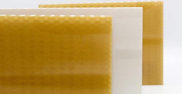

Thermoplastic honeycomb core expert EconCore, Toray Advanced Composites and Bostik have joined forces to develop and commercialize a thermoplastic honeycomb core sandwich panel for use in mass transportation applications, including aircraft interiors.
By using Toray Cetex reinforced polycarbonate (PC) thermoplastic laminates as skins, EconCore’s thermoplastic honeycomb core based on resins with flame-smoke-toxicity (FST) qualification, and Bostik’s flame-retardant thermoplastics polyester web adhesive, the collaboration has seen the new material pass fire, smoke and toxicity regulations applying to aircraft interiors.
The three companies came together to provide a sustainable solution to more expensive and labor-intensive fabrication of parts based on conventional sandwich layup that is currently used in aerospace, such as that of thermosetting phenolic prepreg skins and phenolic impregnated aramid honeycomb core.
The thermoset system requires lengthy and expensive handling and processing of the sandwich components into the final part which can take several hours, including the curing process, whereas, by using EconCore’s continuous process and a compression moulding, the new thermoplastic technology can take around 60 seconds to form the desired shape.
Not only is the thermoplastic honeycomb part less time consuming to make, the thermoplastic solution is by far, more sustainable as the traditional thermoset materials used are not recyclable. When looking to discard EconCore’s thermoplastic honeycomb skin, it can be easily recycled, shredded and repurposed into composites.
