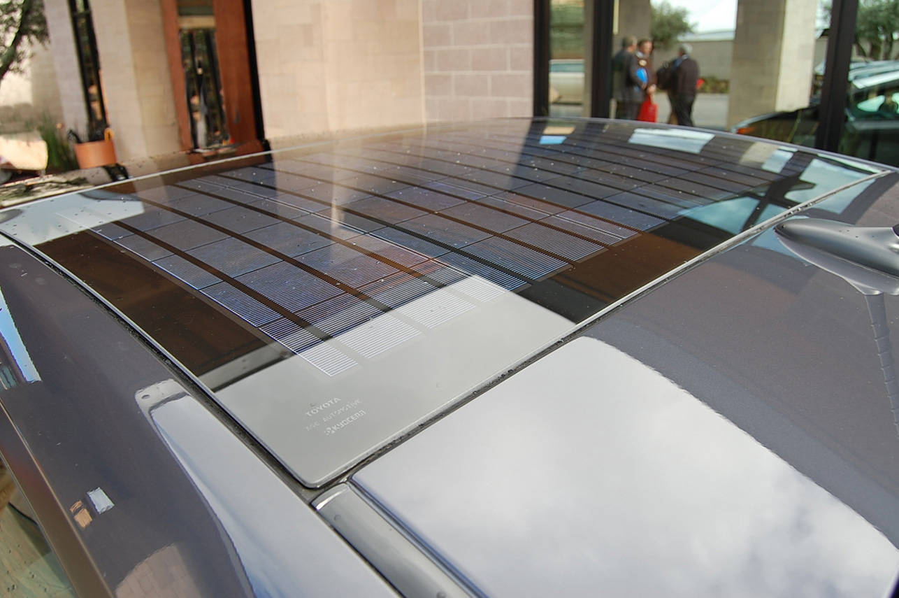

Konarka's lightweight, flexible solar is organic and recyclable, and able to be bonded or laminated to many different materials. Its flexible nature and ability to cover nooks and crannies and fill oddly-shaped surfaces, as well as its availability in many colors, will make it a superior option for integration into car roofs for consumers who are image conscious and want elegant integration.2010_Prius_solarroof.jpg
Toyota Prius solar roof
