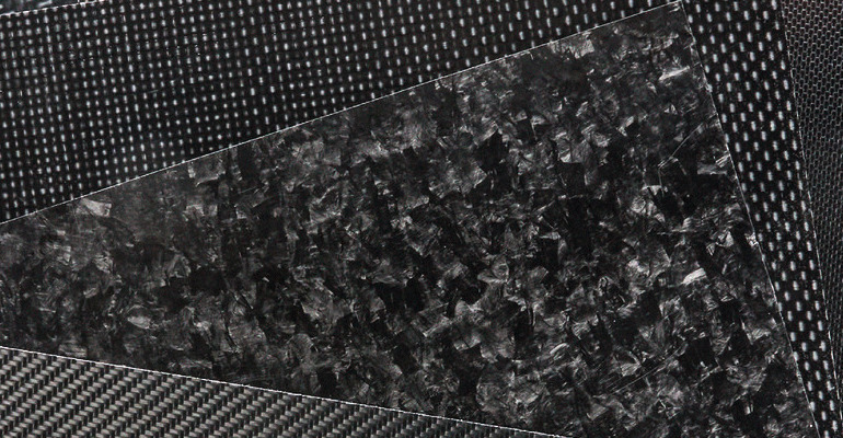

Another new product line comprises variants of Tepex with up to 80% recycled material that yield surfaces with a so-called forged carbon look. The corresponding components feature a grain that is reminiscent of marble. The high proportion of recycled material is based on carbon fibers from post-consumer and post-industrial waste. The fibers are used as non-woven material or chopped fiber mats. A variety of thermoplastics are suitable as a matrix material, such as polyamide 6 and 66, polypropylene, or polycarbonate, whereby types of recycled material made up of these plastics can also be used.
The fibers in the composite semi-finished product have no preferred orientation, meaning that the mechanical properties of the resulting components are isotropic (the same in all directions). The mechanical performance of the new carbon composites approximates the high level of the continuous-glass-fiber reinforced composites of the Tepex range. “We see good opportunities for these products in applications that at once require high-class decor and high-grade mechanical properties, such as in car interiors and exteriors or in housings for consumer electronics,” says Bonefeld.
