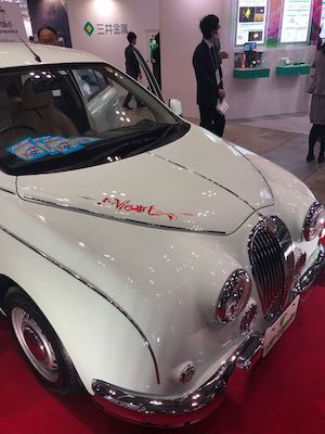

Prototype vehicle fitted with an engine hood made of fiber reinforced composite incorporating modified lignin.

As part of these efforts, research consortium member Miyagi Kasei Co., a processor of thermoset composites using processes such as resin transfer molding (RTM) and infusion molding, has teamed up with boutique Japanese automaker Mitsuoka Motor and the National Institute of Advanced Industrial Science and Technology (AIST) to develop an engine hood and interior components such as door trim and speaker cases made from 40% glass fiber reinforced epoxy composite with a 17% lignin content. The lignin is incorporated in powder form, and contributes to part lightweighting of 4% as well as lower emissions of formaldehyde, acetaldehyde, and styrene during processing.
