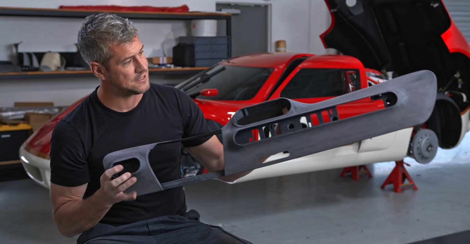

By utilizing various 3D printers and technologies, the team was able to produce parts like a large solid composite firewall sandwich core, printed in two halves on the Stratasys F900 printer in Ultem 1010 resin. The part was bonded together into a single piece and then wrapped with carbon fiber without the use of a layup tool. The design of the firewall included complex mounting features for interior speakers, a fuel filler mount, and the luggage compartment.
Additionally, many exterior items like side mirror housings, radiator ducts, and body vents were printed in FDM Nylon 12 carbon fiber (CF) and ASA materials. Numerous mounting brackets throughout the car were printed in FDM Nylon 12 CF to satisfy strength requirements and allow design freedom while meeting an aggressive project schedule.
