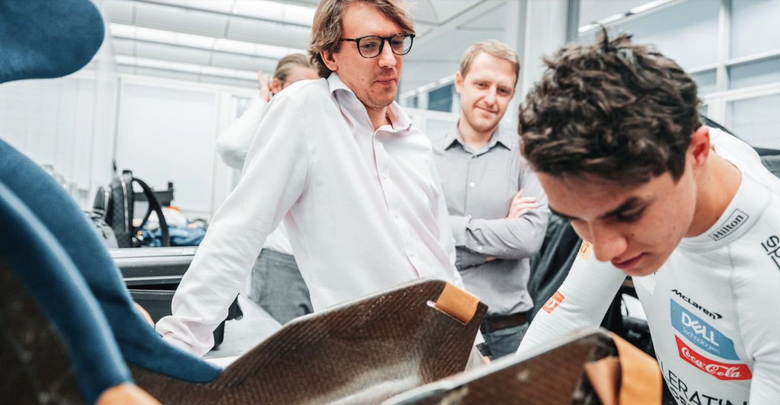

Flax fiber-based composites employed in F1 seat boast greater vibration absorption and impact resistance than carbon fiber. Image: McLaren. |

“With the introduction of the new regulation in 2019, the seat now forms part of the driver’s weight budget, so it’s over-engineered as a result,” explains McLaren F1 Principal Composites Engineer Steve Foster. “And with Carlos and Lando weighing in at 72 kg and 68 kg respectively, there’s plenty of scope to do that. It meant that, if we needed to, there was margin to use additional bio-composite material to ensure sufficient strength and stiffness in this safety-critical component.
“The original carbon fiber seat design was reverse-engineered by Bcomp, and then we optimized and manufactured the new design. The seat was run in pre-season testing without any problems and we hope to be racing with Bcomp flax seats in the near future.”
