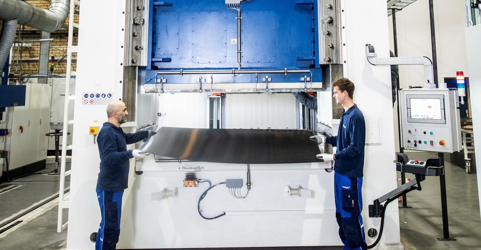

high-heat laminate press for composites
Image: Toray Industries
Toray Advanced Composites has expanded its thermoplastic composite material capabilities for high-performance applications with the introduction of a next-generation high-heat laminate press at its Nijverdal, Netherlands, facility.
This move advances the supply of Toray Cetex reinforced thermoplastic composite laminates for high-temperature performance applications across resin systems, including engineering plastics PEEK, PEKK, and LMPAEK. The press can consolidate composites at temperatures up to 400°C. Laminates are available with woven fabric, uni-directional, and hybrid reinforcement configurations.
Laminates made using the high-temperature press are 50% larger than existing laminates in this performance category, bringing what Toray Advanced Composites describes as a unique capability to the composites market. The increased size broadens the adoption of high-performance thermoplastic composite materials to include larger part geometries across both aerospace and industrial applications.
