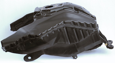

Unreinforced and impact-modified PA 6 used in BMW motorcycle fuel tank meets permeation requirements of U.S. EPA. Photo: BMW Motorrad
BMW Motorrad’s models F 900 R and F 900 XR have been able to meet all of these requirements thanks to a single material. The tanks in both machines are made from Durethan BC550Z 900116 DUSXBL polyamide 6 (PA 6) from Lanxess. The unreinforced and impact-modified PA 6 is injection-molded into two half-shells, which are then welded to form a tank by means of hot plate welding.
