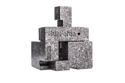

mPPE foam can also be used in the molding of electronic components.
Asahi Kasei has developed SunForce – a particle foam based on the engineering plastic mPPE – as a solution to these challenges. Compared to standard foams made of polystyrene or polyolefin, the use of mPPE equips this foamed material with unique properties, opening new doors for applications in thermal management and fire protection. The material is certified with UL 94 V-0 (Standard for Safety of Flammability of Plastic Materials for Parts in Devices and Appliances) fire protection class by the “Underwriters Laboratories” safety certification organization and thus contributes to overall product safety.
SunForce is the first-of-its-kind material to be certified with the UL94 V-0 standard. In addition to this outstanding flame retardancy, the particle foam provides superior heat insulation properties while at the same time functioning as a lightweight shock-absorbing material for automotive battery packs. The aforementioned properties and features allow functions and applications fields beyond those of conventional foams. The product is also suitable for applications in automotive battery packs, lightweight shock absorbers, sandwich composite cores with carbon fiber, as well as for thermal insulation applications.
In addition to its broad range of properties, SunForce also provides significant advantages from a cost perspective: The material can be processed via steam molding, a manufacturing process that requires significantly less pressure compared to injection molding with a metal mold. The beads are filled into a mold and are then expanded and simultaneously fused with the heat from steam. The steam molding process with lower pressure allows the use of an aluminum mold, which can be produced at 10 to 20 percent of the cost for a steel mold.
The high dimensional accuracy of the material is a key factor for the proper function of the molded part. SunForce utilizes the characteristics of mPPE plastic with its low coefficient of linear expansion in comparison with other plastics and the effects of temperature in the fabrication process are relatively small – allowing a very precise and accurate product design with complex structures. At the same time, the small size of the beads allows the molding of thin walls, while maintaining high mechanical strength and stiffness.
