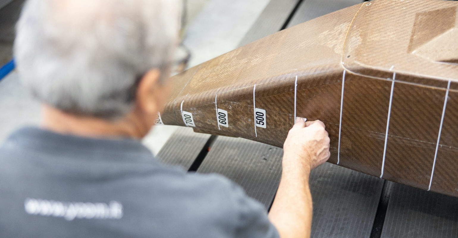

A natural fiber front impact absorbing structure (FIAS) has been successfully crash-tested for the first time. Designed by YCOM and using high performance ampliTex flax fibers from sustainable lightweighting specialist Bcomp, it proves that natural fibers can play an important role for structural- and safety critical parts.
The test proves the concept and opens the door for structural applications of natural fibers in motorsports. Benefits include lower CO2 footprint, viable end of life options, and no sharp debris
The crash box is designed to optimize the performance of the ampliTex natural fiber reinforcements and was tested at the FIA-approved test house Politecnico in Milan, producing results in line with a traditional carbon-fiber structures. The material not only shows the desired, even crash behavior required from a safety perspective, but also eradicates the danger of sharp splintering. Furthermore, natural fiber composites waste can be used for thermal energy recovery.
The test proves the concept and opens the door for structural applications of natural fibers in motorsports. Image: YCOM/Nicola Gennari
For the motorsports industry, this proves that high-performance natural fibers can be used for significantly wider applications than previously thought, reducing the environmental impact, and enabling technology transfer to mobility. The natural fiber FIAS prototype designed as a proof of concept is currently ca. 40% heavier than its carbon-fiber counterpart but still enables a CO2 reduction of approximately 50% on the composite side.
