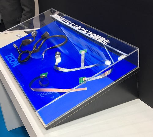

New cyclo-olefin polymer grade targets automotive flat flexible connector applications as well as lightweight glazing. |
Speaking to PlasticsToday at the recent Automotive World show incorporating the 7th Automotive Lightweight Technology Expo in Tokyo, Zeon’s Koichi Ikeda, Product Manager, Specialty Plastics & Components Division, said a development grade dubbed L-24 was being tested as a material for use in automotive flat flexible connector (FFC) systems. One specific example is a 77-GHz band millimeter wave radar system for autonomous vehicles.
Grade L-24 reportedly results in substantially less transmission loss compared with liquid crystal polymer (LCP) and polyimide (PI) resin alternatives. L-24 is also insoluble in 30% caustic soda, unlike LCP and PI. Further electrical resistance is also reported to be superior to the two other competing resins. Dielectric breakdown strength is 250 kV/mm versus around 150 kV/mm for both LCP and PI.
