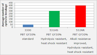

Recent test evaluations show that when specimens are immersed in alkali, cracking occurs within two hours in standard material Duranex 3300 and in hydrolysis- and heat shock-resistant Duranex 531HS. However, no stress cracking occurs in Duranex 532AR even when immersed for up to 200 hours.
Electrical components and sensors installed near the engine are often metal insert molded and there are cases when sudden temperature changes can cause heat shock fracture. This occurs because the metal and resin have linear expansion coefficients that differ by roughly a factor of 10. Duranex 532AR has outstanding heat shock resistance and is capable of withstanding these harsh environments.
