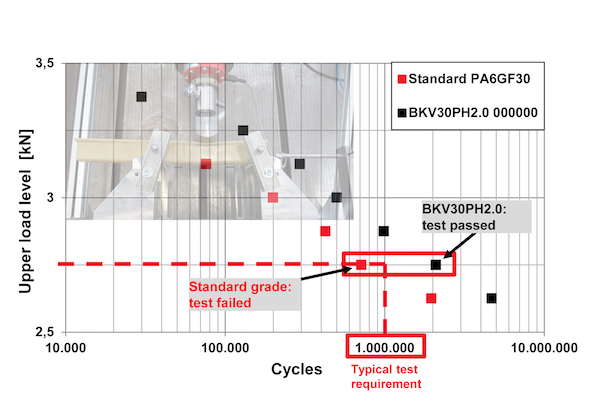

Lanxess has investigated the dynamic behavior of the new compounds on a demonstrator resembling lightweight structural components. This so-called HiAnt element is an injection-molded U-shaped profile that is reinforced on the inside with crosswise ribs. Among other tests, three-point-bending fatigue Wöhler experiments were carried out with this practically oriented test specimen. Linder: “In these tests, Durethan BKV30PH2.0 showed a service life around three times longer than a standard polyamide 6 material with 30 percent glass fiber reinforcement at a bending load of 2.75 kN.”
