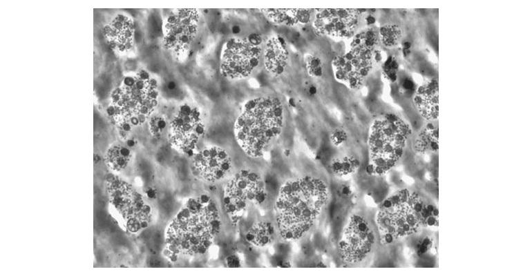

SEM image of polyamide blend
Image: RadiciGroup High Performance Polymers
To maximize polymer performance, Italy’s RadiciGroup High Performance Polymers has introduced a specialty range of polyamides (PAs). The Radilon Mixloy products are made by blending readily available polymers via a compatibilization technology that makes naturally immiscible raw materials miscible.
