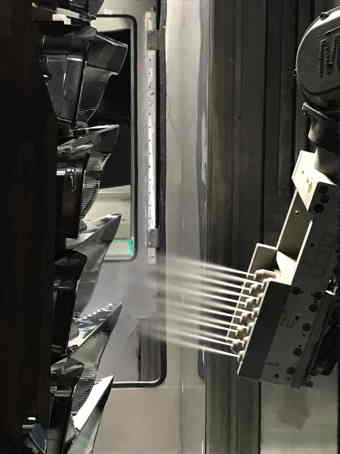

The patented two-component ring nozzle ensures good and even cleaning results. The array used by Nanogate Jay Systems is fitted with twelve nozzles. [Image source: acp – advanced clean production]
By adjusting process parameters, such as volume flows for compressed air and carbon dioxide, cleaning time and motion sequences, exactly to suit the parts being cleaned, the contamination-related reject rate could be reduced to almost zero. [Image source: acp – advanced clean production]

The core of the quattroClean system is a patented, wear-free circular two-component nozzle, through which the CO2 is fed. On exiting the nozzle, the liquid CO2 expands to form fine CO2 crystals. These are bundled by a circular jacketed jet of compressed air and accelerated to supersonic speed. The non-abrasive jet of snow and compressed air has a temperature of -78.5°C. Since this can be directed highly accurately, practically all the CO2 is used for cleaning, and the process achieves uniform cleaning results throughout the entire work area.
The high level of cleaning efficiency is based on a combination of thermal, mechanical, sublimation and solvent effects, which are activated when the jet impacts on the cleaning surface. Thanks to these four cleaning mechanisms, the quattroClean system reliably removes filmic contamination, such as residues of separating agents and fingerprints, as well as particulate contaminants like de-burring residues and dust. “We achieve much better cleaning results with this technology and have been able to reduce the contamination-related reject rate to almost zero. It takes less than one year to achieve a return on investment,” remarks Taylor.
Nanogate Jay Systems now uses three quattroClean systems, which are operated six, or sometimes even seven, days a week in three shifts. Tailored by acp to the company’s exact requirements, the systems take the form of a robot with a nozzle array. The latter has twelve nozzles with a total jet width of 120 mm. Liquid carbon dioxide and compressed air are fed to the array via a hose system.

To clean the various reflectors, about 30 part-specific programs are filed. The MES selects the appropriate one in each case. The workpiece carriers containing the reflectors are processed fully automatically. These are cleaned, coated with basecoat, metalized by PVD to apply a reflecting layer of aluminum, and then packed. The dirt cleaned off is swept away by the aerodynamic force of the jet and removed via an integrated extraction unit, thus preventing parts from becoming recontaminated.
Since process parameters, such as volume flows for compressed air and CO2, cleaning time and motion sequences, are adjusted exactly to suit the parts to be cleaned, optimum cleaning results are assured. In addition, only the amount of CO2 or compressed air required for the process is used. “We are so pleased with the quattroClean system and our working relationship with acp that we are already talking about integrating the system into more of our paint lines”, concludes Taylor.
