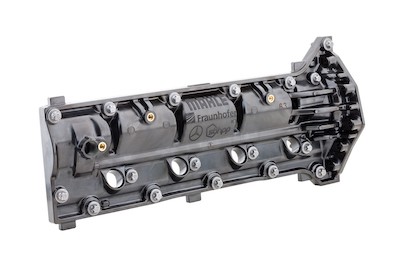

Camshaft modules, which are a key component of powertrains, are still being made from aluminum. Now a research team from the Fraunhofer Institute for Chemical Technology ICT, in collaboration with their partners, has succeeded in manufacturing a camshaft module from fiber-reinforced thermoset polymers using the injection molding process. This lightweight design element helps lower engine weight and reduces assembly costs. It is currently available as a functional demonstrator.
The camshaft module features a monolithic
design with integrated bearings. © Fraunhofer ICT

The camshaft module features a monolithic design with integrated bearings — in other words, it is manufactured in one piece, thus reducing assembly time in the engine manufacturing plant. Car manufacturers receive a pre-assembled module from their supplier and can mount it on the engine with just a few simple mounting operations. This eliminates the need for separate, time-consuming installation of the camshaft. This innovative solution boasts an additional advantage: aluminum inserts in highly stressed areas of the camshaft bearings absorb the direct forces.
Although the stiffness of the thermoset polymer is only a quarter of that of aluminum, design measures enabled the research team to adhere to the maximum allowable deformation. After 600 hours of testing on the engine test stand, the lightweight design element demonstrated flawless functionality in a state-of-the-art internal combustion engine. With the aid of the planned fuel injection tests, the project partners now want to prove the functionality and the NVH characteristics taking the gas forces of the combustion process into account.
