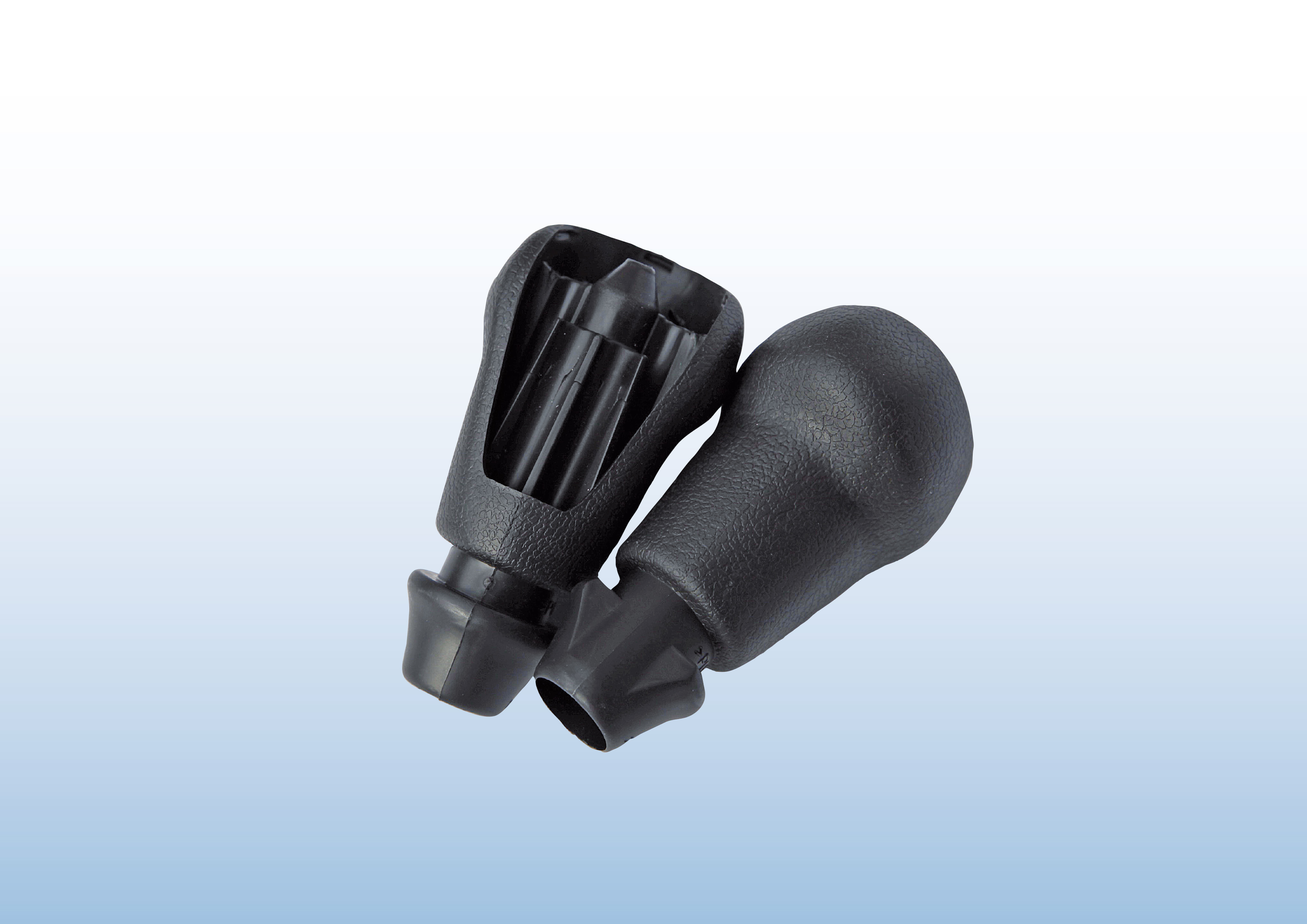

Long the realm of thermoplastic polyurethane elastomers (TPUs), gearshift knobs may have reason to switch their allegiance to polypropylene (PP), which promises weight and cost reductions, as well as processing advantages such as no requirement for pre-drying. POLYfill PP Touch grade 35025Q UV from Swedish compounder Polykemi AB is currently being evaluated for potential replacement of a TPU material in an automotive gearshift employed by a global automaker. A weight saving of 15% is achieved in the gearshift knob, and the grade is easily processable via injection molding to boot.
Injection-molded soft touch PP is a cost-effective, lightweight alternative to TPUs.
