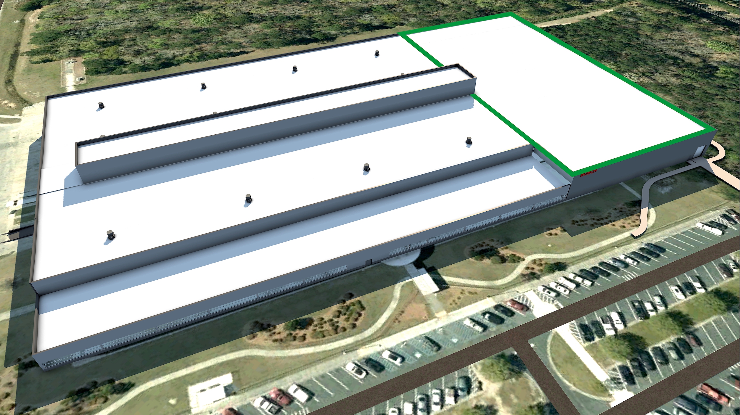

Bosch is expanding its existing Charleston, S.C. plant to add electric motor manufacturing capacity there.Image courtesy of Bosch
