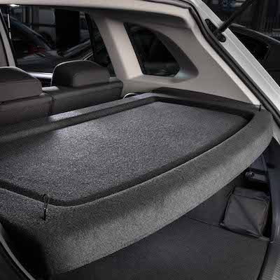

Load bearing floors (above) and parcel shelves (below) are commercial examples of recyclable, thermoplastic composite material solutions for vehicle interior trim parts.
Renolit Tecnogor is a recyclable, glass fiber (GF) reinforced PP-based, lightweight thermoplastic composite material. It has been designed to cost-effectively produce automotive interior trim parts. Tier 1 converters are able to combine superior part performance with consistent quality and higher productivity, while also achieving lower production costs as it can be 3D shaped in a ‘glue free’ one-step-process.
