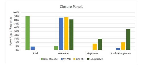

The greater the mass reduction target, the more plastic composites are set to come into play. |
The data also shows that, while 90% of existing closures are made from steel, as little as a 5% lightweighting objective in a vehicle will likely result in an 85% transition from steel to aluminum. Additional efforts to lightweight the vehicle beyond 5% will begin to introduce magnesium and composites, with slightly greater growth in composites. Composites growth was found to be dependent on aggressive vehicle lightweighting at 10% and 15%.
