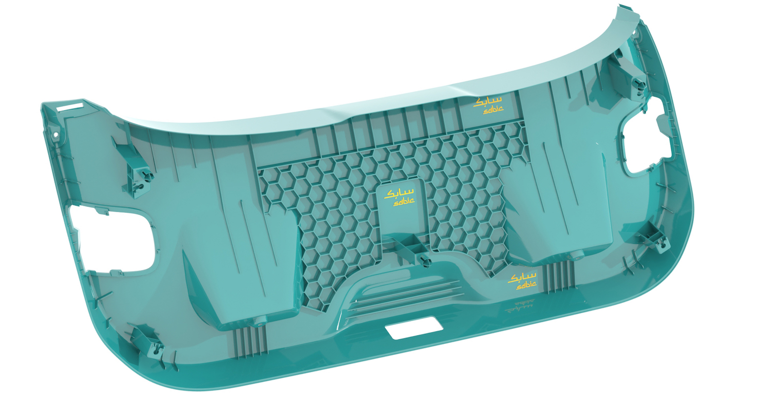

Back of an inner tailgate trim part that is foam injection molded with Sabic PPc F9005 grade.Image courtesy of Sabic

Finished inner tailgate trim part made with Sabic PPc F9005 grade through foam injection molding. The molded part features fixations, ribs, honeycomb, doghouse, domes, holes, textures, and excellent aesthetics. Sabic’s PP compound has high flow, can decrease sink marks, and reduces weight by up to 30%.
