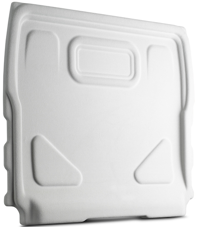

Sabic announced a new, cutting-edge technology for producing lightweight, cost-effective and recyclable vehicle panels using its Udmax tape, a unidirectional, fiber-reinforced thermoplastic composite at the recent JEC World 2019 event. This innovative technology, which is designed to replace traditional panels made of metal and thermoset materials for interior and exterior automotive applications, will soon be commercialized in the bulkhead of a light commercial vehicle (LCV) produced in large scale for the global automotive market.
Produced using a highly efficient, one-shot process of lamination and low-pressure molding, the bulkhead featuring Udmax tape is 35% lighter and complies with ISO 27956 standard for securing cargo in delivery vehicles.

The use of thermoplastic composites can lead to a significant reduction in mass in applications. In the case of the bulkhead, replacing a traditional metal component with the Udmax tape lamination within the part reduced mass by 35 percent in the application. Lower weight can also make the large bulkhead easier to handle, which could help to accelerate vehicle assembly.
This mass saving can be achieved without sacrificing the impact performance of the part, which is essential to protect occupants against injuries caused by shifting cargo. According to RLE International, the bulkhead complies with ISO 27956, the standard for securing cargo in delivery LCVs. The build-up of the process and the tensile strength of the Udmax are the main factors in optimizing the impact resistance of the bulkhead.
Compared to metallic or injection molded part of a conventional, multi-piece bulkhead, the new method – designed, developed and engineered by RLE International – can reduce tool costs by up to 80 percent compared to injection molding tools. This saving is due to the ability to replace an expensive, high- pressure tool with a lower-cost, low-pressure tool. Overall, the supplied cost of the LCV’s bulkhead can be 10 percent lower than the conventional metallic bulkhead that it replaces.
This technology also represents a revolutionary change in vehicle panel production by increasing efficiency and reducing complexity. With molding cycle times under two minutes, this streamlined process avoids sourcing and assembling multiple components, traditionally at different supplier locations, as well as secondary painting and trim operations.
A proprietary lamination featuring a core of extra-wide Udmax tape woven by Setex incorporates aesthetic finish a one-shot compression step. The process also allows varying the thickness of the panel in order to improve noise, vibration, and harshness (NHV) levels, helping to reduce noise in the vehicle. AMA Composites created the tool and molded the concept parts.
