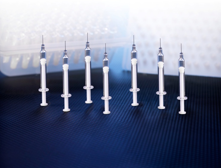

The Daikyo Crystal Zenith prefillable syringe system is the market’s first silicone-oil-free syringe system. |

The Daikyo CZ 1-ml-long insert needle syringe system is the market's first syringe system without silicone oil lubrication. Insert molding of the needle eliminates the use of adhesive. The company says that silicone oil can cause protein aggregation. Use of Daikyo Flurotec barrier film on the drug contact surfaces provides lubricity, so there is no need for silicone oil. The film also provides a barrier against organic and inorganic extractables.
The syringe barrel is manufactured from Daikyo's proprietary Crystal Zenith, a cyclic olefin polymer that can be autoclaved at 121ºC and is said to have very good low-temperature characteristics.
