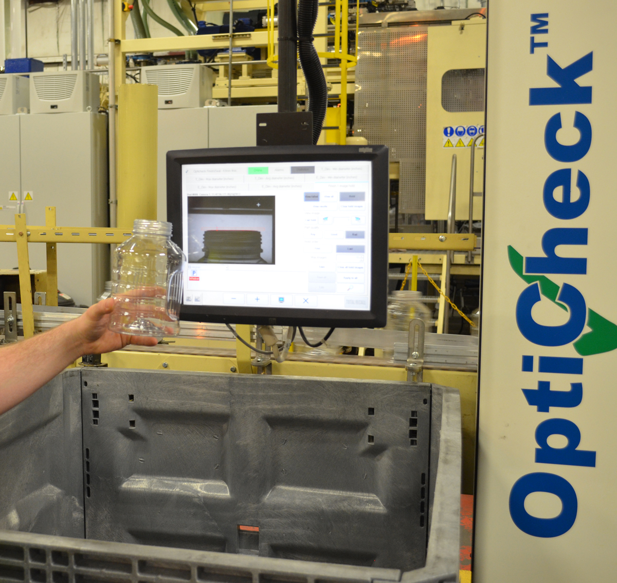

Agr-opticheck-gr.jpegInstalled in the blowmolder, the Process Pilot uses a combination of software and high accuracy sensors to proactively manage material distribution throughout the container. Downstream, the OptiCheck ensures that all output meets specifications before entering the filling line.

Because jar finish is critical to protect product integrity, the containers go through one final inspection step before being conveyed through the wall to the filling plant. Graham personnel view the Agr OptiCheck, a compact inspection and measurement system, as their "last line of defense." The OptiCheck's finish gauging module uses a proprietary configuration of multiple cameras, LED-based backlighting, and high-speed imaging to measure container dimensions inline to an accuracy of 0.002 inches. The system's image analysis algorithms identify flaws and blemishes, such as whiskers left from trimming, rejecting jars that could pose seal surface-related problems.
