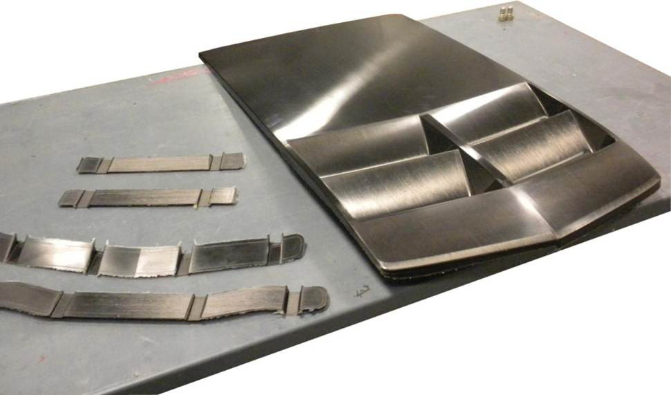

"We had downtime because of the recession in the housing market," he said. Bamford threw significant resources into development of the machine, which cuts processing time for a carbon composite part from more than 90 minutes to the 17- to 19-minute range. Further process improvements are expected to drop cycle times further.
Bamford said that the pressure and temperature profiles required for Plasan's new process are comparable to the requirements in wood composite processing.

Test part shows process capabilities.
