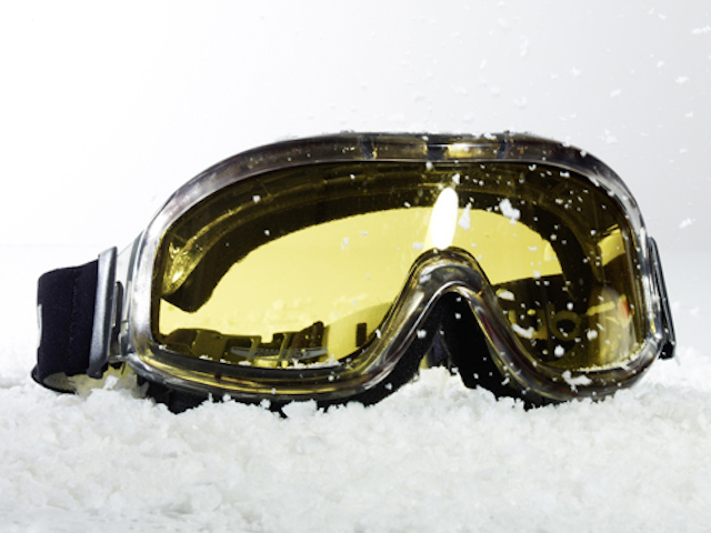

Goggles with lenses made from a mold by ABCO Tool.
