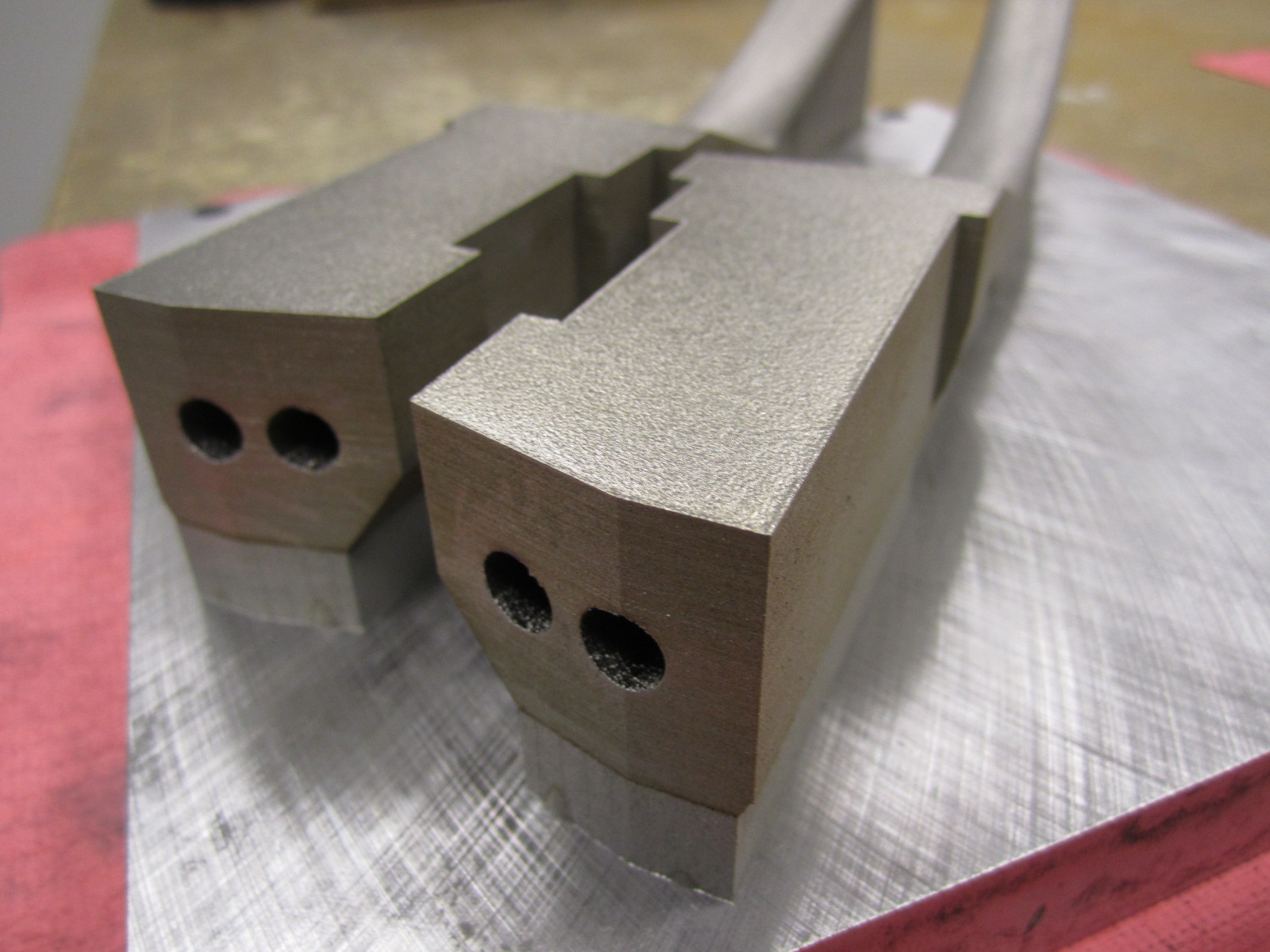

DMLS has made it possible to create core and cavity inserts using DMLS, quickly and cost-effectively. The inserts can cost anywhere from 10-35% more than a conventional tool insert, but the payback can be easily recouped on the cost savings in both cycle time and quality improvements. "If the tool insert design is provided with the conformal cooling channels designed and engineered by the customer, the inserts can be produced in as little as 3-5 days," explains Tenbusch. "However most projects require the cooling lines to be designed and FEAs provided, and this can add both time and costs to the project."

Linear continues to use DMLS for prototype tools by adding "grown" inserts where EDM burning may be required or for lifters and slides, and in production mold components such as subgates, slides and small cores and lifters. However, the real interest for the technology is for conformal inserts, primarily because of the cycle-time reductions companies typically get with conformal cooling technology.

Linear currently has three DMLS machines from EOS, including an EOSINT M-270 that it installed earlier this year, and will be adding a fourth machine sometime in the first quarter of 2012. A high speed F5 Makino machining center was purchased in June of this year to do the hard-milling of the grown inserts. This provides Linear with the capability to do the finishing work on the grown DMLS components or provide them directly to the mold shop building the mold to do the finishing. The company also operates eight injection molding presses ranging from 33-1000 tons where the company performs mold tryouts and qualifications, and also does some non-automotive production molding. "Our strategy is to make Linear into a full-service niche provider," says Tenbusch.

Part of the reluctance on the part of moldmakers to use the DMLS technology is that the metals offered now are very different than what are typically used for molds in North America. Typically, North American mold manufacturers use P20, S7 or H13 materials. "The Maraging steel that is used in the DMLS process isn't well known in North America, and that's one of the biggest hurdles," Tenbusch says. "It's not a commonly recognized tooling material here, however in Europe it is used in both injection molds and die-casting applications, and is available in billet or bar form. We have found that it's not readily available in North America in these forms, is limited to certain sizes and it's expensive."
Maraging steel is an alloy that provides superior strength and toughness without losing malleability. It's similar to the stainless family, and contains nickel, cobalt, molybdenum and titanium, which makes it good for aerospace applications. For mold inserts, Tenbusch said it has been used in Europe in tools that have seen a million or more molding cycles. While Linear does not have a tool in house that has hit those types of volumes yet, Tenbusch notes that "We have some inserts that we've hit 125,000 or 130,000 shots with glass-filled nylon material without any visible degradation of the mold," he says. "We are not very concerned with the maraging material tool life. When it is hardened to 50-53 Rockwell it machines and finishes (SPI-B2) like other billet materials of similar hardness."
