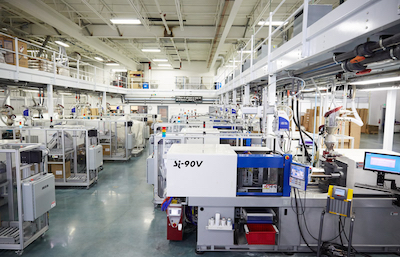

The manufacturing process at PCI's Bunsen Drive facility is so unique that the company was awarded US Patent No. 8,827,674 B1 for the process: A specialized injection molding factory system and associated facility comprising machines on the first floor with the resin supply placed on a mezzanine level.

Today every press PCI brings in is hard-wired with RJG controllers and every mold has RJG sensors. "The only way you can run an essentially unattended facility like Bunsen Drive 24/7 is to know the process is in control for every shot," said Duffey. "Sensors let us know of any anomaly in the run and the parts conveyor reverses itself to move those parts to a different container. If this happens three times, an alarm goes off and the press shuts down. That alerts the process engineers at the Morse Drive facility, and someone drives the 45 seconds over to the Bunsen Drive facility to address the problem."
"The only other real human involvement is when we have a process engineer for mold setup or changeover or material handling of the boxes of parts," Duffey added. "Each morning, material handlers pack up the boxes and load them on the box-handling system, then set up boxes for the next 24 hours, making sure the Wittmann raw material handling systems on the mezzanine are filled."
Each manufacturing cell consists of a 90-ton press, sprue picker, under-press reversing conveyor, box handler, press-side grinder, RJG system, and Wittmann raw material handling system. A complete 90-ton press automated cell averages a cost of about $300,000, noted Duffey.
