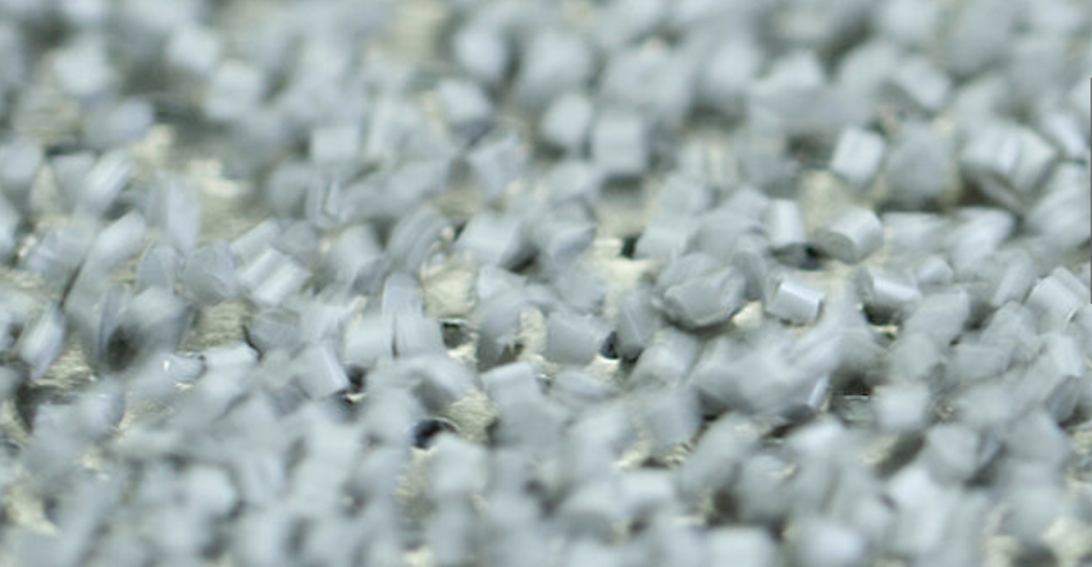

Germany’s Romira has developed a PC/PBT blend with particularly high impact strength, reduced warping tendency and increased UV stability. Romiloy EXP3008, among other things, exhibits very good performance in the area of UV resistance.
PC/PBT blends are construction materials that combine the advantages of amorphous polycarbonate (PC) and crystalline polybutylene terephthalate (PBT). PC provides impact strength and dimensional stability, while PBT adds chemical resistance and stiffness to the blend.
The new blend, Romiloy EXP3008, is not only characterized by improved chemical resistance (towards fuels, fats / oils and many cleaning agents), high dimensional stability and UV resistance, but also by especially high impact strength and is therefore particularly suitable for demanding parts in outdoor applications.
