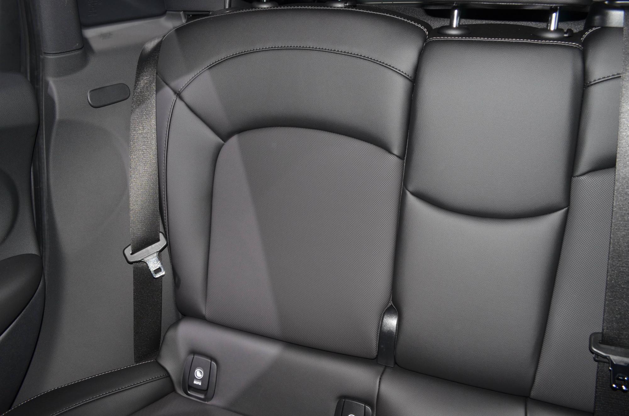

Soft touch reinforced PP used in the rear quarter panel of the new 5-door Mini. (Source: A2Mac)
One such application is the Rear Quarter Panel in the new 5-door Mini that was manufactured using a soft-touch Softell-PP compound that reinforced with 25% glass fiber. Compared with the PC/ABS mix that has been used previously, Softell TKG 300N reportedly demonstrates improved haptics and lower weight and allows for a matte surface finish that meet the interior design criteria of the customer. Added customer advantages are a favorable balance between toughness and stiffness, low emissions, UV stability and scratch resistance.
