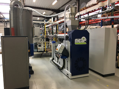

Flexible extruder for honeycomb production can handle a wide range of thermoplastics from polyolefins to engineering thermoplastics.

At the heart of the upgraded line is a purpose-built 50-mm extruder, built by MEAF Machines B.V. (Yerseke, The Netherlands) and equipped with a special 500-mm sheet die built by flat-die specialist EMO Extrusion Molding (Micheldorf, Austria). EconCore and MEAF collaborated closely on the design of the laboratory extruder, which is equally capable of processing polyolefins, bioplastics and high-performance thermoplastics such as polycarbonates, polyamides, and polyphenylene sulfide.

The MEAF extruder has a 50-mm barrel holding a screw with an L:D of 34:1, which is typical for polyolefins. However, it also has a superior heating capability, with each of its five zones rated at 5.8 kW. Despite this high power rating, the extruder is highly energy-efficient, in line with MEAF’s philosophy of creating extrusion systems with low carbon footprints. A 600-L dryer for hygroscopic materials is fully integrated into the production system. Maximum output from the extruder is around 150 kg/h.
