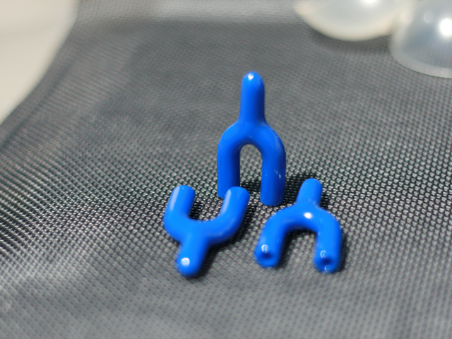

One company specializing in dip molding and coating is Molded Devices Incorporated (MDI), which works closely with a variety of OEMs across many industries such as medical, aerospace and defense, automotive, construction, and industrial. Dip molding and dip coating applications include the production of various sized medical balloons, endoscope components, and cannulas with highly customized material formulations and precise dimensional tolerances; protection for high-end glass and metal components against chipping, scratching, corrosion, static in PCB components, and many more highly customized applications.
For example, a customer came to MDI with a grommet requirement spec'd in a thermoplastic elastomer (Santoprene) that would be produced by the injection molding process. However, the program for this component didn't have the volumes needed to justify the injection mold required to do the job (the estimated annual units on this particular part was <10,000 pieces). MDI was able to manufacture this component utilizing a proprietary process developed for other similar applications. And the tooling was designed and built for under $500. MDI says that it was also able to keep the per piece price within the customer's budgeted range, making the grommets cost effective at the lower volumes.
Another project for which dip molding provided an ideal solution involved a customer that manufactures high-value titanium products requiring many different machining operations. After discovering a high rate of returns due to minor scratching or small "dings" in the product due to the handling of the products, they came to MDI looking for a solution. "Together we developed a protective dip-molded cover used in the plant to protect the product as it moved between stations during the various operations, greatly reducing returns and rework costs," said Dave Schoell, Vice President of Sales for MDI.
Dip molding can also be used to compete in blow-molded applications for bellowed products. "One customer initially reached out to a blow molding company for a bellowed gear shift cover," explained Schoell. "The blow molding company came back with tooling and cutting fixture costs in excess of $70,000. MDI made the mandrels for under $500 and a lower part cost as well."
As seen by these examples, dip molding and dip coating can be used in a wide range of applications from protective coverings, medical applications, recreational equipment, sound dampening, circuit board protection, in fitness equipment, bumpers, soft grips on power tools where haptics (touch) are important, lawn and garden, and steering wheels, among others.
