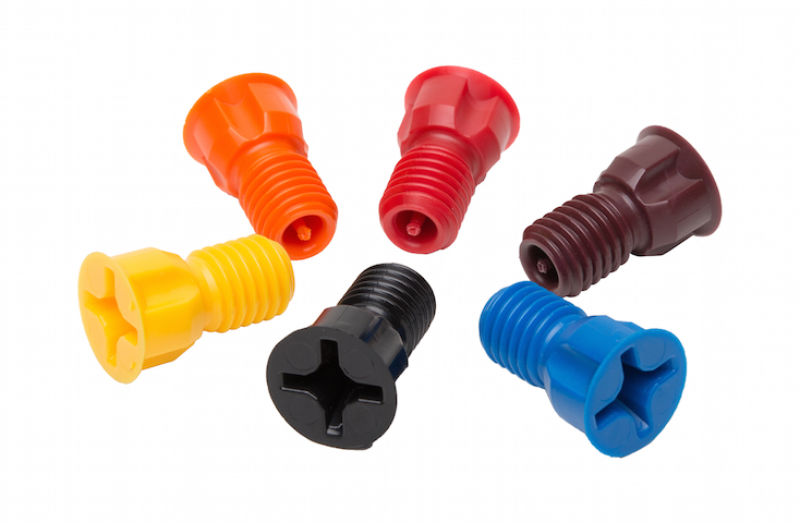

When producing a sealing plug for its industry-standard A8001 clamping fixture, Hasco identified that the walls of the ABS plastic sealing screw would need to be 12-mm thick to seal the large number of threaded holes. Given this geometry, it was clear that the screw could not be produced using a conventional injection molding process. With the level of intricacy enabled by Stratasys Polyjet 3D printing, Hasco redesigned the screw with a reduced wall thickness and subsequently 3D printed a mold insert to the new specifications in order to test the integrity of the design before mass production.
stratasyshascomold400.jpg"The speed of the process was incredible," explains Paulmann. "Using our Objet 500 Connex 3D production system, we produced the parts of the cavity that shape the polymer—such as the inserts and slides—in just six hours compared to the 24 hours it previously took. We then worked with prototyping specialists Canto Ing. GmbH, in Lüdenscheid, Germany, to finish the 3D-printed inserts and test the sample mold. We were delighted with the result. The first sealing screws were produced ready for mounting on our clamping unit in a record time of only four days.
