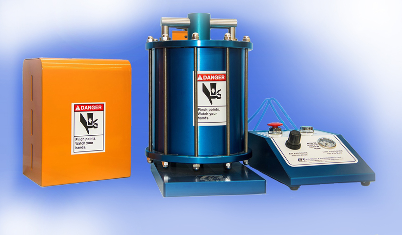

M.R. Mold & Engineering
Stuffer box for liquid silicone rubber processing is designed by
M.R. Mold & Engineering.
Rick Finnie, President of M.R. Mold & Engineering Corp. in Brea, CA, said he didn't actually decide to get into building equipment for processing liquid silicone rubber (LSR). "It evolved because we wanted to make ourselves more efficient," Finnie commented. "The development of the cold runner system came about because we were purchasing systems to use with our molds. Our customers began commenting on how they wished we could make some significant improvements in the systems. We listened to our customers and designed and developed our own cold runner system, along with a valve gate controller. At the time, molding machines rarely had that capability."
Finnie also developed a pneumatic stuffer box, which evolved because it was costing the company far too much time and money when sampling each mold. "We had to tear down the entire pumping unit for the next material," he explained. "Putting our heads together, we came up with a way to bypass the pumping unit and make our lives so much easier."
Customer feedback on his products helps Finnie make improvements on the company's original designs. "Because of customer feedback, we have improved on our original designs," he said. "For example, a single-drop cold runner for prototyping and a high-volume stuffer box were both the result of customer input."
