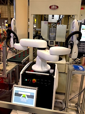

Increased market needs for insert molding are also proving a boon for Nissei’s vertical injection machines. The tiebarless TNX100RIII8V was combined with a two-arm, six-axis Kawasaki robot that could pick up randomly placed inserts and set them in the mold, as well as undertake demolding and assembly operations. The era of selling machines alone is over, notes Nissei.
