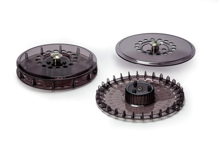

ELITechGroup Biomedical Systems, a leading global manufacturer and distributor of in vitro diagnostic equipment and reagents, chose a transparent Radel polyphenylsulfone (PPSU) resin from Solvay Specialty Polymers (Alpharetta, GA) to injection mold two redesigned carousels for its Aerospray slide stainer systems used for hematology and microbiology applications.
March 24, 2015
ELITechGroup Biomedical Systems, a leading global manufacturer and distributor of in vitro diagnostic equipment and reagents, chose a transparent Radel polyphenylsulfone (PPSU) resin from Solvay Specialty Polymers (Alpharetta, GA) to injection mold two redesigned carousels for its Aerospray slide stainer systems used for hematology and microbiology applications. Radel PPSU delivered chemical resistance, toughness, and the ability to withstand repeated steam sterilization, and it expanded design options compared with competitive materials because of its compatibility with ultrasonic welding.
ELITechGroup had traditionally used a transparent polycarbonate (PC) resin to mold the tops and bottoms of its 12- and 30-slide carousel designs, as well as the thermoplastic caps that retain magnets in each carousel. However, PC frequently exhibited crazing and cracking after repeated exposure to the harsh chemicals common to slide-staining applications. To amend this, the company set out to redesign its carousels by sampling several alternative transparent materials to mold the carousel parts, including polyethylene, polyvinylidene fluoride, polybutylene terephthalate-based blends and a copolyester material. It also sampled a competitive PPSU, before selecting Solvay's high-performance, transparent Radel material.
In addition to the aforementioned properties, the material was selected because it enabled the design engineers to streamline assembly operations by allowing the use of ultrasonic welding to retain the magnets within the carousel.
ELITechGroup's two carousel designs integrate magnets to enable the slide stainer to detect the part's rotational position as well as the number of slide placements it has. Because the carousel and magnet caps are both injection molded using Radel PPSU, it is a comparatively simple and cost-effective step to firmly bond these parts together using ultrasonic welding.
Radel PPSU is resistant to methanol, iodine, phenol and other chemical agents that are applied to slides via atomizing spray nozzles inside ELITechGroup's diagnostic systems. The material also can withstand repeated steam sterilization and maintain its toughness and impact resistance.
