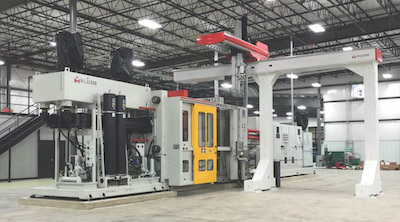

Milacron has aggressively expanded its rebuild and remanufacture capabilities for LPIM machines for customers. There are a large number of old LPIM machines in the field that were purchased in the late 1980s and 1990s that need rebuilds and upgrades to control systems and new motor and drive selections, moving away from DC to AC drives which provide better energy efficiency. Milacron’s full remanufacturing consists of fully rebuilding the machine to current model specifications, including full teardown and inspection, platen refurbishment, full re-painting of the machine, new controls, electrical system, and hydraulics. The major tonnage and injection cylinders and hydraulic accumulators are sent out for refurbishment and resealing. New screws, barrels, and injection melt accumulators are also included as part of this program.
Hallstrom added, “Essentially we are updating machines that have been in production for over 30 years and bringing them up to the same specifications as our new machines. This has been especially popular since we started to promote this capability to our customers, as they see a significant enough savings since we are re-using the most expensive parts of these large machines, being the bases, platens, and cylinders. The customer gets back a machine that outperforms the machine’s original specifications and is as reliable as a new machine with the same warranty.”
At NPE, 20/20 entered into an agreement with Milacron to refurbish and upgrade two of their existing 400-ton LPIM machines to 500-ton LPIM machines, and one of their 500-ton LPIM machines to 750-ton LPIM machines. 20/20 is also having Milacron rebuild and upgrade five of their 750-ton LPIM machines. The machines will undergo a complete remanufacture and rebuild process at Milacron’s Batavia, OH manufacturing plant and be returned like new machines.
