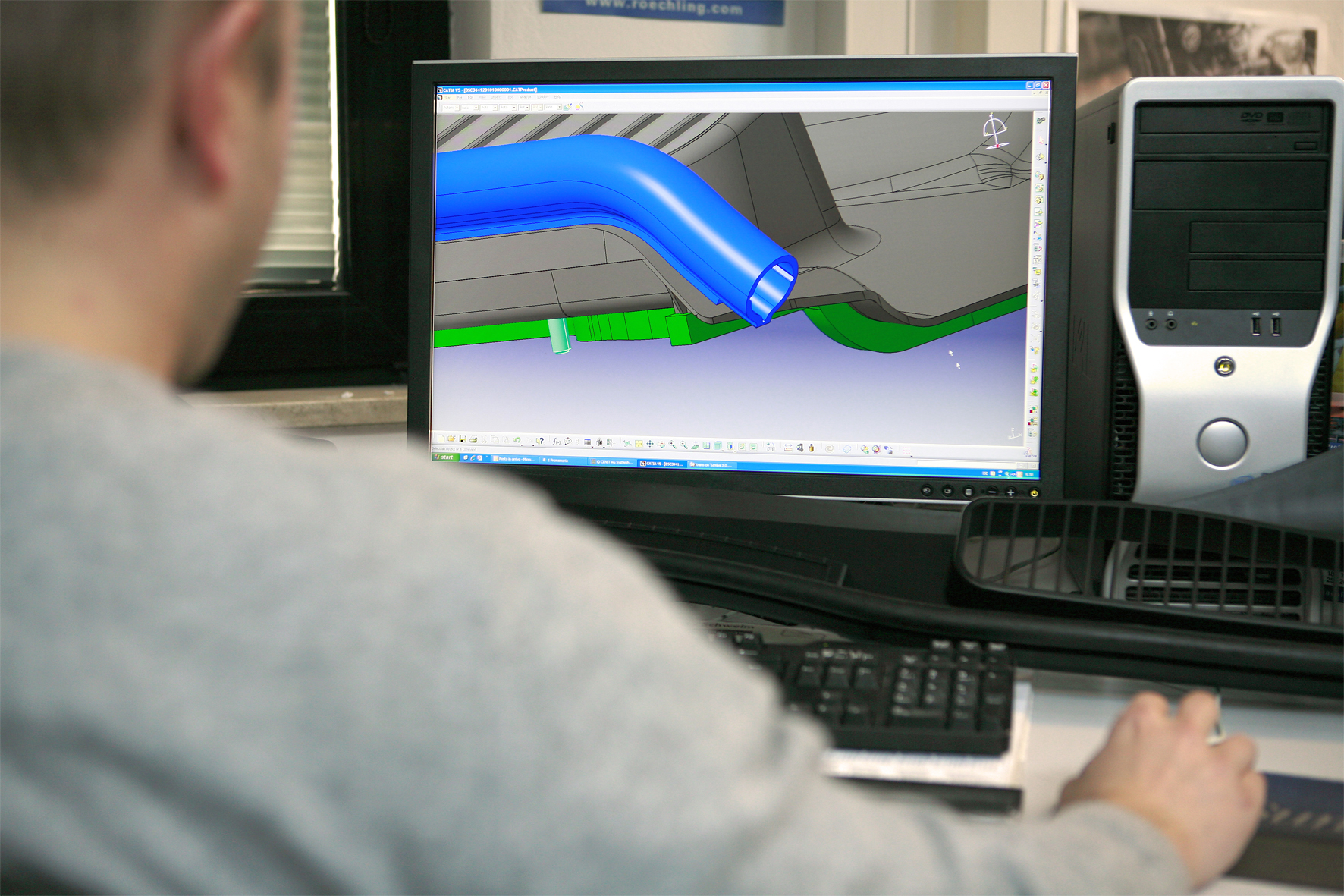

The processor recently shared results of another project which involved injection molding of a cowl grill / engine cover bulb seal, molded in a one-shot process, with parts exiting the mold ready for shipment to the customer. The two-component process saves about 30% weight and 10% costs compared to the previously used assembly of the two components, while also lowering the rate of quality problems. "The two-component PIT-cowl grill eliminates assembly and quality costs. Instead of higher parts costs the bottom line shows savings of 10%," says Matteo Piazzi, product manager at Röchling Automotive. "Material and weight savings of 30% come on top. Rising raw material costs thus improve our competitiveness further." In this case, EPDM was the sealant material, not TPE, with the carrier again molded from polypropylene.
According to Röchling, its PIT process is faster than gas injection, and can form parts with lower weight. Versus water injection, says Röchling, PIT creates parts with a better surface structure (fewer voids or pits). The P in PIT is a winged polyamide projectile shot through a partially filled cavity, propelled by inert gas at pressures ranging from 200-300 Bar so that a hollow part (such as a seal) with uniform walls is created. The projectile is not recovered but Röchling has created a system to recapture the melt that is forced through the cavity, and feeds this melt into a future shot.
On the new cowl grill / engine cover project, the molded carrier and the hollow elastomer seal had been made separately, with the PP carrier injection molded and the EPDM seal extruded, and then assembled together in a separate process. The seal can be manufactured in lengths of up to 1.5 m with constant wall thickness and complex 3D shapes, says Röchling. The wall thickness can be varied to suit different sealing or force requirements along the length of the seal; this has advantages for pedestrian protection and hood flutter avoidance.
The molded seal can follow tighter radii than an extruded seal, claims the processor. The seal compensates for vehicle tolerances of up to 10mm in line with closing pressure. The seal can be made longer, shorter or equal to the length of the carrier. It can also comprise T- or V-shaped junctions.
After the hard component of the cowl grille (the carrier) is molded, a slider in the mold opens to allow the seal cavity to be filled with elastomer material. The projectile then forces the majority of the still-liquid EPDM out. The ejected material is recycled for use in the next cycle, and the warm carrier chemically bonds with the seal.
