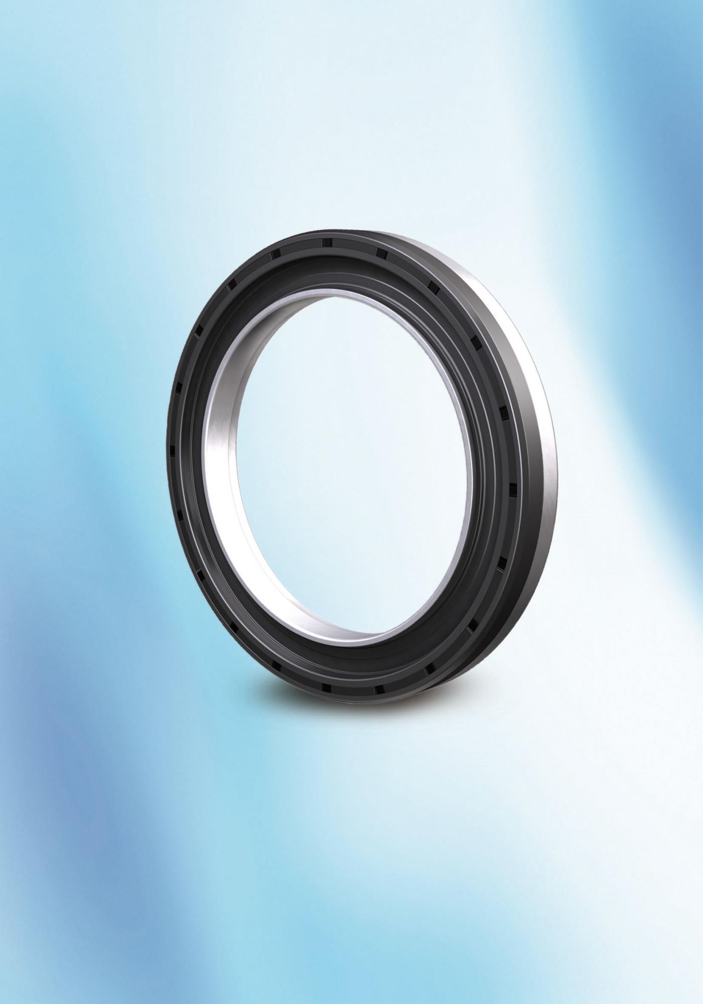

Seals face new challenges in engines fueled by biodiesel.
