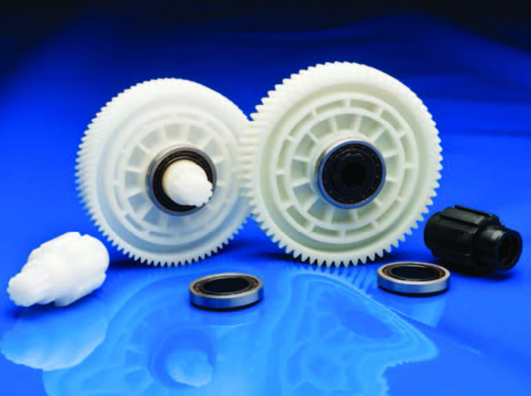

Gear-019_CelaneseHiLexAutoLiftGateSS_AM_09131.jpegCelanese is seeing more activity in the medical and business machine market segments for moving parts, and especially for smaller gears. A driving factor in those markets is the move to get away from grease or oil in general.
The automotive market is a large gear market as well. Celanese materials for gear applications contain a tribological modifier which offers excellent wear resistance and allows manufacturers to get away from external lubricants. "We offer a full portfolio of tribological grades and our new Hostaform SlideX resins offer best-in-class of performance of coefficient of friction and wear" Rubcich said. "Eliminating grease is the goal because grease adds cost and attracts dirt."
The vast majority (95% +) of plastic gears are in POM acetal which provides a good combination of mechanical properties and lubricity, and the cost structure is good as well, explained Sheridan. "In many automotive applications, plastic gears can see upwards of 100 degrees C," he noted. "Acetal is the best for these applications. Additionally, Acetal has great resistance to grease and oil, which is common in automotive parts. However, the biggest inroads for plastic gears are in the business machine industry—there's a real drive to get grease and oil out of business machines."
In one instance, an innovative transmission from Hi-Lex America Inc. continues to reliably and quietly open and close automotive lift gates thanks to high-precision shafts injection molded with Celcon acetal copolymer (POM) and Celstran long fiber reinforced thermoplastics (LFRT). The two-stage reduction transmission of the leading supplier of automotive electromechanical, power closure devices and control cables use precision steel ball bearings mounted on plastic shafts and 2.5-inch diameter plastic gears to achieve the desired reduction between the electric motor and a flexible torsional cable.
The first-stage gear and shaft and second-stage output plastic gear are injection molded from Celcon acetal copolymer (POM) M90 and Celcon GC25T, respectively. The second stage output shaft is injection molded from Celstran PA 66-GF50-02. The Hi-Lex transmission with plastic gears reduces cost, weight and especially noise.
