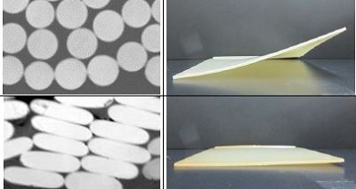

Japan’s Nippon Electric Glass has developed flat glass fiber which features an elliptical cross section. The glass fiber can be cut into chopped strands of fixed length (3 mm) for reinforcing thermoplastic compounds that are characterized by greatly reduced warpage.
Elliptical cross section chopped strands (bottom) used to reinforce thermoplastics can significantly reduce warpage in molded products compared with conventional round glass fibers (top). |

The elliptical chopped strands also lead to improved dimensional stability as compared with conventional chopped strands with round cross sections. Further, Nippon Electric Glass proprietary surface treatment for the flat glass fibers further improves strength and surface appearance.
