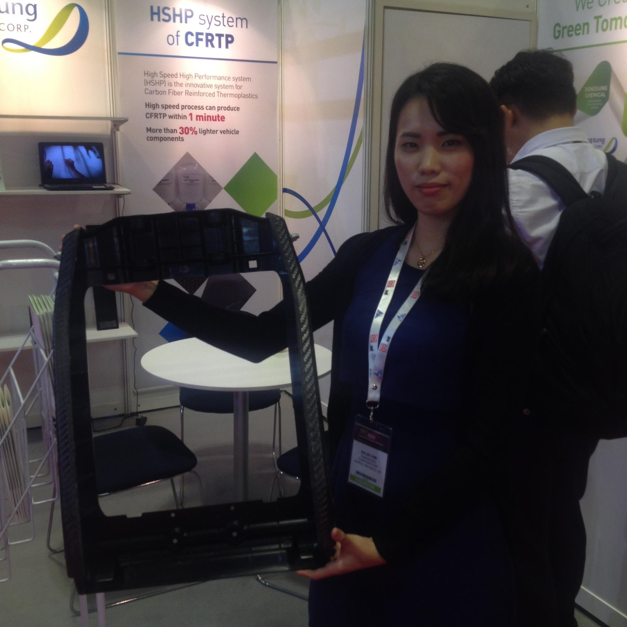

Tim Kim, Executive Director of Dongsung Corporate R&D Center says: "TPU is used as the matrix resin in order to impart impact strength to the part." He adds, "three CFR-TPU prepregs are compression-molded in a one-minute cycle prior to back injection molding with polyamide resin." Dongsung is currently working with a Korean Tier 1 to commercialize the technology. The prepregs are formed using a belt process.
Dongsunglores.jpgSeat frame uses an interesting combination of long
carbon fiber and TPU resin to realize rigidity and
