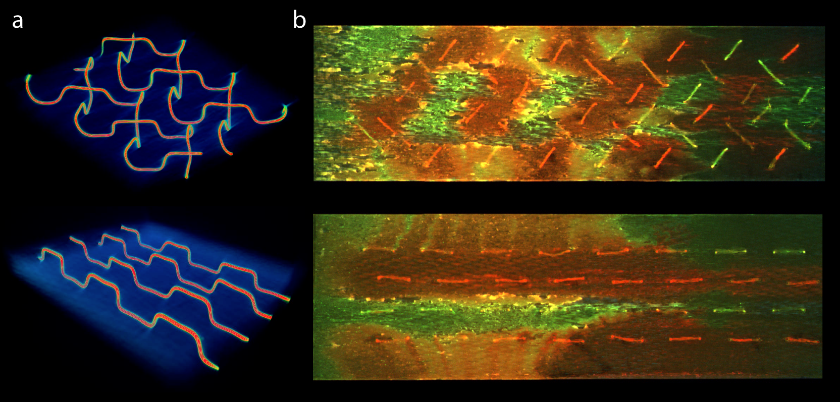

3D microvascular networks for self-healing composites: Researchers were able to achieve more effective self-healing with the herringbone vascular network (top) over a parallel design (bottom), evidenced by the increased mixing (orange-yellow) of individual healing agents (red and green) across a fracture surface. Credit: Jason Patrick

The vessel system is made up of two different micro channel networks, each containing one of the two liquid healing agents (an epoxy resin and hardener). Delamination damage ruptures the capillary network and triggers the delivery and subsequent polymerization of reactive chemical species. Two different vascular architectures were tested, in order to determine the best configuration, which would allow the healing agents to combine effectively after being released within the crack.  The researchers found that arranging the vessels in an overlapping, "herringbone" design promoted a better mixing of the liquids compared to a parallel configuration. As the researchers wrote: "In the parallel configuration, diffusion is primarily limited to adjacent bands between the delivered healing agents. In contrast, the herringbone pattern enhances mixing through increased interfacial, and overlapping fluid boundary layers."
 "When a fracture occurs, this ruptures the separate networks of healing agents, automatically releasing them into the crack plane-akin to a bleeding cut," said Jason Patrick, a Ph.D. candidate in civil engineering and lead author. "As they come into contact with one another in situ, or within the material, they polymerize to essentially form a structural glue in the damage zone. We tested this over multiple cycles and all cracks healed successfully at nearly 100 percent efficiency." Remarkably, after each healing cycle, it was found that higher loads were required to propagate the crack in the test samples with the herringbone configuration. The researchers attributed this higher healing efficiency to the improved fluid interspersion in the fracture plane.
