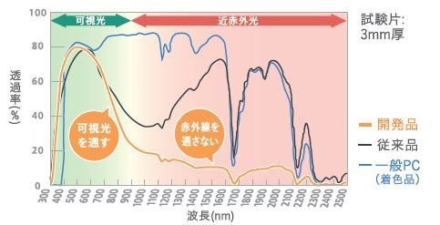

A new grade of polycarbonate (PC) boasting enhanced heat-absorbing performance while maintaining high visible light transmission properties is targeting automotive glazing applications. Developed by Sumika Polycarbonate Limited, grade SD Polyca HA2093M transmits 77.9% of visible light whereas its solar transmittance is only 45%, compared with 55.9% for an existing Sumika grade and 76.4% for a standard colored PC grade.
Latest polycarbonate grade from Sumitomo Chemical affiliate Sumika Polycarbonate shuts out IR irradiation, and in doing so has a cooling effect in vehicle interiors. The orange line indicates transmission in the visible (shown in green) and IR (shown in red) spectra. The dark blue line is for an existing heat absorbing grade, and the light blue line for a standard colored grade. |
