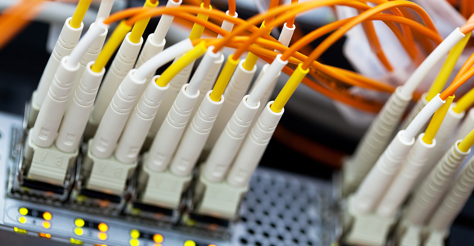

molded electrical components
Image courtesy of Sabic
Upcycled polybutylene terephthalate (PBT) resin with thin-wall, non-brominated/non-chlorinated flame retardance (FR) has been added to Sabic’s portfolio of iQ compounds. LNP Elcrin WF0051iQ is suited for the fabrication of miniaturized electrical components as well as critical medical devices and appliance applications, according to Sabic.
