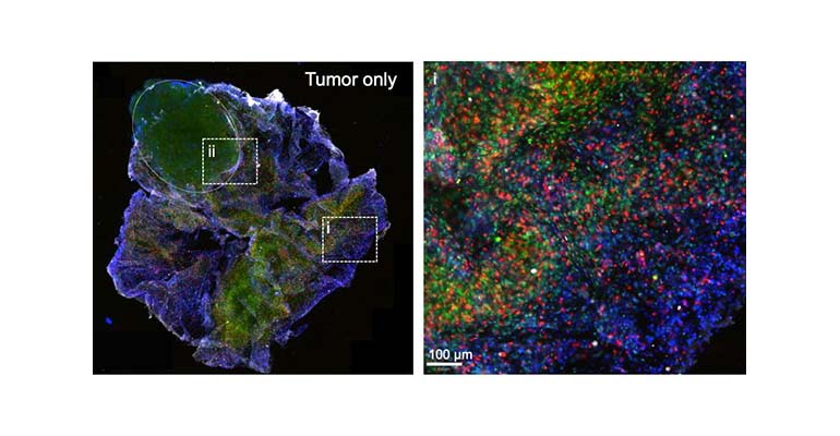

The BioArm can print a tumoroid in about 90 seconds on average. In their study, the researchers used live cell imaging and image analysis to assess if the tumoroids could be used to test potential therapies as part of drug-discovery pipelines. Using high-resolution imagery, they were able to see the immune cells infiltrating the tumoroids, and discovered that the immune cells stimulated with immunotherapy moved faster than the other cells.
“Bioprinted cancer models mimic the 3D heterogeneity of real tumors,” said Corrado Mazzaglia, first author of the paper and research associate in the Biointerface Research Group. “BioArm has the potential to screen a range of tumor therapies and could play a crucial role in the future development of cancer drug testing approaches.”
