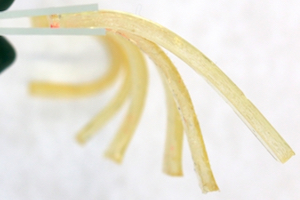

Caffeine is a stimulant that many people rely on to jump start their day and get them on the other side of the mid-day hump. It turns out that it also does a number on polymers. Researchers at the Massachusetts Institute of Technology (MIT; Cambridge, MA) and Brigham and Women’s Hospital (Boston) are using it to catalyze the formation of polymer materials. They have devised a way to create gummy, biocompatible gels that could be used for drug delivery and other medical applications, and it all begins with a cup of deep black joe, or at least its active ingredient.
Image courtesy the researchers/MIT News Office.
