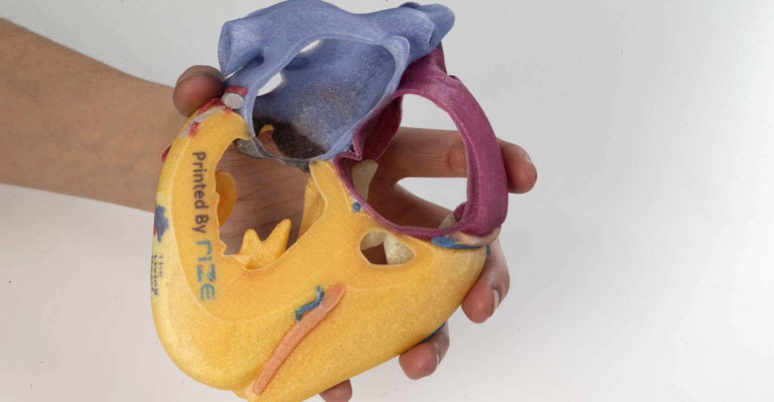

Rizium GF brings the strength of composites to 3D printing of medical models, such as the brain stem pictured here. Image courtesy Rize. |
The material’s durability allows users to create products that stand out, added Kalambi. “They can create full-color prototypes of medical devices, with the inks incorporated into the polymer itself . . . prototypes that are realistic and support even complex geometries without warping or cracking. Since Rizium GF is chemical- and moisture-resistant, it can be sanitized with isopropyl alcohol, and moisture does not get absorbed and create traps for virus, bacteria, or other particles,” said Kalambi.
