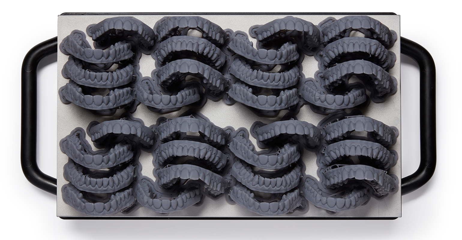

The Form 3L and Form 3BL have a build volume of 33.5 × 20 × 30 cm (13.2 × 7.9 × 11.8 in), five times larger than the Formlabs Form 3 desktop SLA 3D printer. The printers feature an intuitive workflow, automatic resin dispensing, easy-to-use software, and a robust end-to-end system designed for nonstop throughput with minimal intervention. Users have access to nearly all of Formlabs' materials library, including biocompatible materials on the Form 3BL.
The Form 3BL is optimized for biocompatible materials used in the dental and healthcare industries. It has been thoroughly validated by Formlabs’ dental team to meet the accuracy requirements for dental aligner production, with consistent part quality and accuracy across the entire build plane. The Form 3BL also is capable of printing human-scale anatomical models in-house on a single build platform, allowing healthcare providers to produce custom surgical guides in very tight timeframes.
