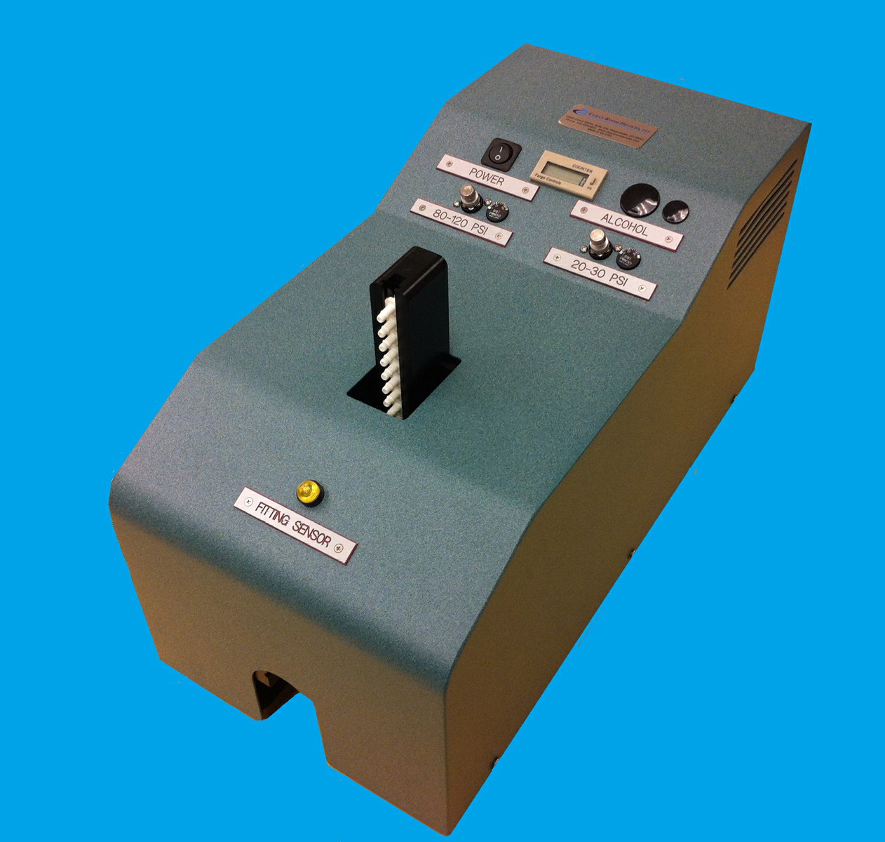

Clean Room Devices, a specialist in tubing assembly equipment based in Westminster, CO, is introducing an Automatic Fitting Inserter that allows high-speed assembly of tapered-barb connectors and tubing made from thermoplastic elastomers (TPEs).

New assembly tool for TPE tubing. (Teknor Apex)
"Tapered-barb connectors fit into the Medalist TPE tubing with a retention strength that exceeds the 35.6 N (8.0 lbf) level specified by most global OEMs for infusion systems and is greater than levels achieved with either adhesive or solvent bonding," said Richard Faulkner, medical market manager for the Thermoplastic Elastomer Division of Teknor Apex. "The automatic fitting inserter developed by Clean Room Devices enables medical product manufacturers to obtain strong, secure connections even at very high assembly speeds."
The CRD 600 unit cycles at a rate of 2,300 per hour and, with the addition of a feeder bowl, enables an operator to make 1,800 insertions per hour, including time for handling the tubing and inspecting the results, according to Ronald Del Valle, president of Clean Room Devices.
"Because the CRD 600 allows for insertion of over-sized barbs into tubing with a smaller internal diameter, it ensures a stronger fit than solvent bonding," Del Valle said. "A big advantage of our system is that it eliminates the presence of solvent chemicals and odors in the clean room."
